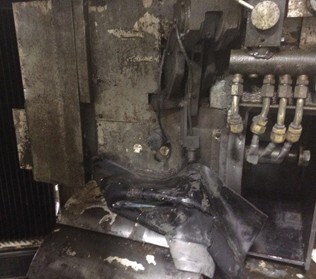

inside of cnc grinder full of dirt and debris
What you see in this photo is a classic example of one of the most lethal “productivity killers” for grinder changeovers – dirt and debris. Cleanliness is a key factor that makes a big difference in your setup time, and there are a variety of common problem areas that should be monitored. Here are my tips for how you can get back to making parts in the shortest amount of time.

Cleanliness, even on changeovers, is important. When you replace a tailstock center, be sure the new one is clean. Debris will keep the tailstock from seating properly, and there will be movement that causes vibrations, chatter, and inconsistent part sizes.
Coolant Cleanliness
Coolant cleanliness is another big factor. If you don’t have a coolant filtration system that removes the swarf, the dirty coolant gets in the interface where the grinding wheel and the part meet, and the very small chips, or metal swarf, create little scratches in the part’s finish. Also, dirty coolant could reduce the grinding wheel life because of having to dress it more frequently. If a machine doesn’t have a proper coolant flush, it puts more emphasis on the operators taking care of the machine to make sure there is no swarf buildup. If there is enough swarf buildup, it can block the coolant flow.
