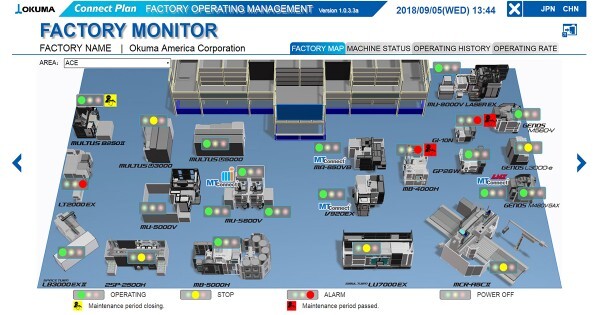

Okuma Connect Plan machine monitoring visualization of shop floor

Data collection is currently a hot topic, and Okuma has shown functionalities in this arena for several years now. At this year's IMTS we unveiled Okuma's Connect Plan, which is a complete package offering both data collection and artificial intelligence (AI), and is a fully supported product. Connect Plan can look at your data, tell you where your problem areas lie, and show you how to improve productivity.
The Dreaded Yellows
Most plants are focused on eliminating yellow conditions for their machine tools. Yellow typically signifies that something needs to be resolved, such as adding more materials, removing a blockage, or waiting for an operator to return to the machine. But how can you capture these seemingly random occurrences, and resolve them for once and for all?
A Learning Component
Connect Plan's AI looks at dozens of different system variables and parameters and makes an assessment as to why the machine is yellow. It can do this because the AI has a learning component to it, where over time, if you tell it you're waiting for tooling, or an operator, the next time this happens the machine recognizes and identifies this problem. When these patterns repeat over time, the AI can pick it up a lot faster than a person can, plus it can assess much more complex scenarios.
Savings Add Up Quickly
Connect Plan can be used to shave minutes off yellow conditions and ultimately, eliminate them altogether. Minutes add up to hours of additional productivity, and the bigger the plant, the bigger the savings. When you have a lot of machines that are occasionally blocked or starved from material flow (or some other issue), this would present a formidable challenge to untangle using a manual process. But using AI to pinpoint trouble spots and resolve them means the savings can add up quickly.
