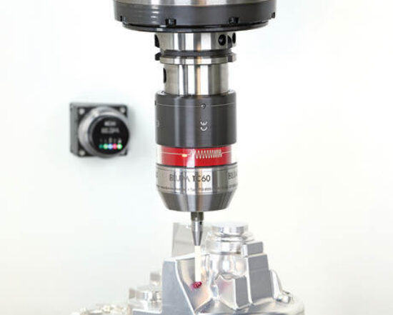

The first step when considering gaging is to think about the parts you produce.
Is there a point in the process where the part is clean (free of chips or coolant), or you can make it clean for measurement? Contaminants can throw off your measurements, so the parts must be clean. It’s also important to consider your angles of approach to the part. Do you have a clear path where a straight probe will work? If not, you can investigate other options such as angle probes or multi-tip probes. In any case, the size and shape of the probe selected should be able to access the part while clearing all its features.
It’s also important to do some planning to confirm that you have the macros that will be needed to make your in-process gaging work. This is another area where we’ve seen vendors placing a focus. Today there are a lot more macros available so shops can do more with gaging routines.
The size and shape of the probe selected should be able to access the part while clearing all its features.

Probes are fairly straightforward in terms of components. The round probe consists of a receiver and a shank, and they come in different sizes.
In the early days of usage, probes were hardwired, which meant that if you broke or damaged the wires, the probe would be dead. This caused some difficulty because replacements were needed. The next generation of gages used radio-style probes, which functioned very well for working within the line of sight, but if you got out of the line of sight the probe was inoperable. The current technology uses a multiple signal receiver, so we can put up to four probes in the machine that have different configurations of styli and measure the features differently.
